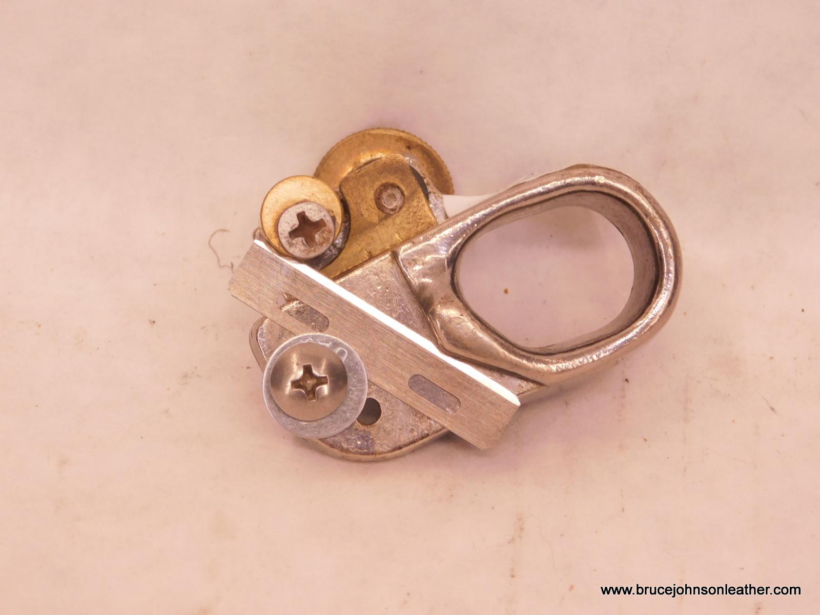

I get them once in a while. Nothing special and on a par with the decent crafters grade swivel knives from the 60s. A step above the cheap bottom end craftool knives. A bit of a collectible for the people who collect swivel knives.
Daniel, one observation here. Do you think it has been rehandled? That purple hue to the finish looks like the handle is more recent and not the original rosewood handles. Any thoughts? Nice clean knife overall.
