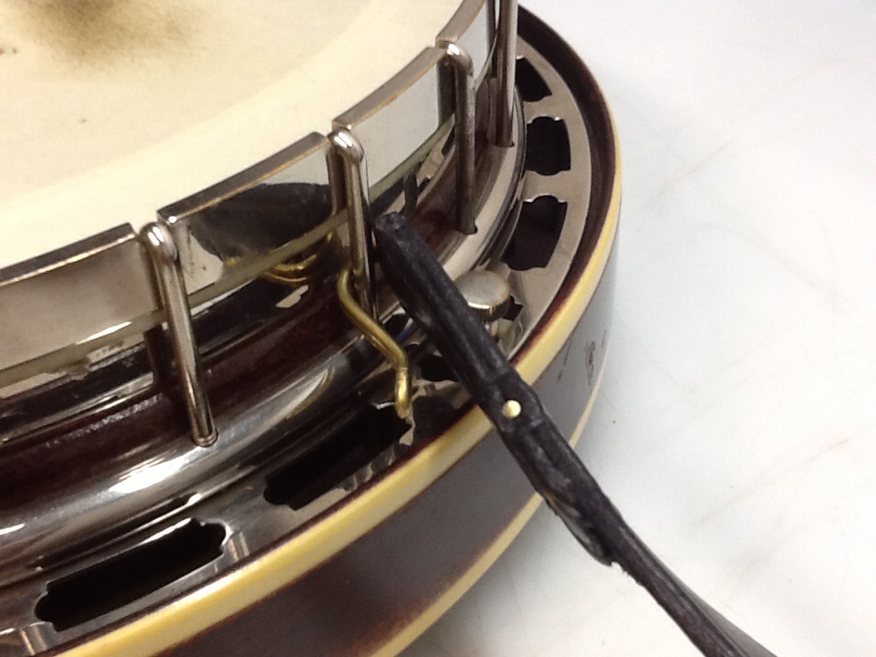

Colt, no, the hooks don't rattle - not even close to the cheap, all metal snaps. The two working musicians that use my banjo straps love them. Funny, the first player I made a banjo strap for is a working musician - he insisted on snaps and I really didn't want to use them, So,I came up with my own design. It took quite a bit of playing to get the dimensions and process down but now they go together fairly easily. That being said, the hook on one end and a shield on the other certainly is not a time efficient design but it makes my work readily identifiable, showcases my pride in workmanship and attention to detail.

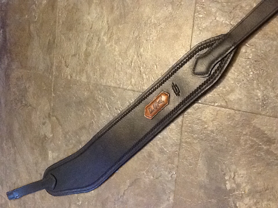

Finished a banjo strap, today, for one of our local working musicians. 6/7 oz. veg tan with a 2/3 oz. soft chap leather liner. Hand stitched at 7 spi.
Beautiful work, thanks for sharing!
Looks really good ... Nice and clean. Congrats on the Tele build! When you finish it be sure to post a pic of your strap on the guitar!

I thought that some of you might like to see the banjo strap hook I designed. The player insisted on a snap and rather than use the mass market cheapies I decided to take another route. I have used it on three straps now. The players love it. I use 3/32" brass rod, bend it to shape, make up a pigskin loop to "hang" the hook inside the leather turn-over, glue it up and stitch. That hook ain't going nowhere! A shot from the front It's a labour intensive solution but it works and looks great!
