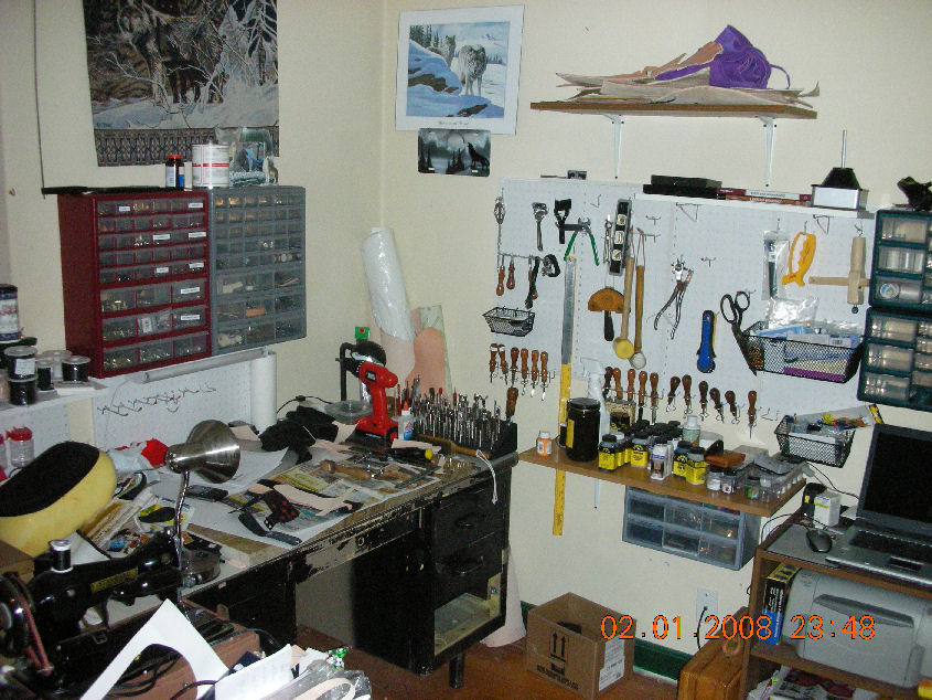

Ok, NO picking on me for not cleaning up.... The first four pix are from (I think) when i first moved my work area into the spare bed room.... I have re-arranged it quite a bit since.... And here are a few pix showing how my work area, not unlike cancer, has spread out and claimed more area.... My 2 foot carving florescent light: -

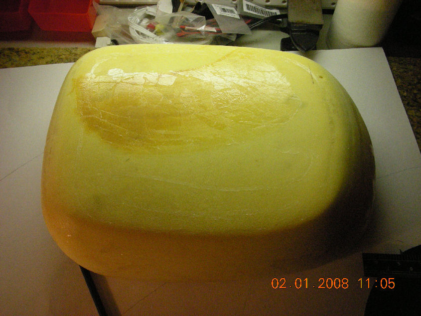

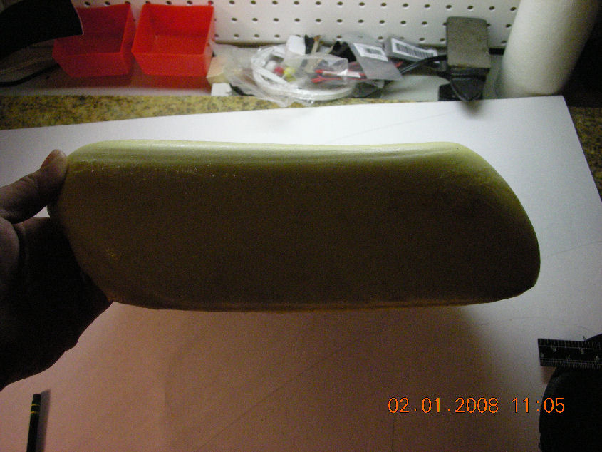

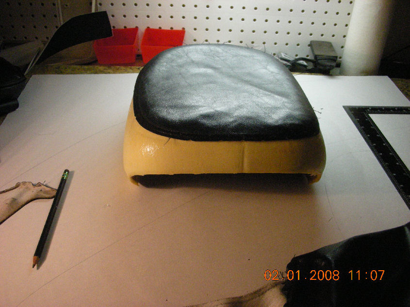

What I want to do is wrap the entire side with one piece, starting at the front which is pictured here: And tool the MAGNA Logo on the back here: I am thinking I can cut a 6 inch strip the full length to wrap around leaving 1 1/2 inch to fold under the seat to be attached to the plastic pan. I am thinking I can stretch the leather around it, and connect the ends and allow it to dry, then cut it at the proper height, then take it and cut a top to match the freshly cut sides. Then remove the side, tool the Logo in the back of the side, then align the top with the side and put my holes into the side and top to accommodate the lacing to attach the two together. then dye and finish the two pieces, then lace them together and attach to the pad and pan, and then lace up the seam in the very front of the side where the two ends come together. then wrap underneath the pad to the pan and attach to the pan.... What is wrong with this series of steps? Will this work?

I dont think rivets will work on the plastic pan.... end up breaking the plastic.
