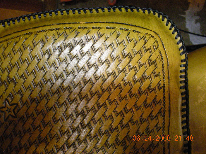

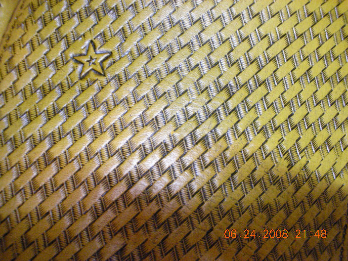

I have been working on learning how to recover my motorcycle seats now for maybe 7-8 months now. I have been too scared to do anything on the main because I felt it was too complicated with the contours and all so i started with the passenger seat first... couldn't get it with the way i was trying.... After posting back and forth with Beeza, when I wanted more info on making a pattern to make the cover for the main seat, he told me he doesn't make and use patterns when recovering thick cushioned seats. He wet molds them, and suggested I just jump in there and do it. So I did. It turned out nice. Not what I had in mind, but I intend on going back and adding the lace here in the future. The decision to go with tan (Feibings antique Tan is what I used) was made back when i first did the passenger back rest from input from this site. When I asked, it was suggested I use Super Sheen as my finish on the seats and no one chimed in telling me that it was a mistake.... So this is what I used. It worked fine on the passenger backrest but the backrest has had no one using it, it is more there for decoration as I don't have a passenger seat on the bike for anything to sit on...... I said screw it and pushed aside my fears and did like Beeze briefly instructed me to do on my main seat. Along with the main seat, I have an after market custom backrest for the main, from Utopia that I wanted to cover too. I did the main with the wet mold method, and did the utopia backrest with a sandwich method. I did both with tan antique (thanks Johanna for the method of application with the fur), and finished the backrest with super sheen, and through another thread (maybe the same where Johanna mentioned the method of applying antique) I was informed that Leather Sheen is the same as Super Sheen just in an aerosol form, so I finished the main seat in Leather Sheen. Below are pix of the finish of both the backrest and the main seat. Take a wild guess at just how pissed I am.... I don't know if the whole thing is screwed.... if it is going to salvageable? If I can "strip" the finish, leave the antique on the leather, and refinish it with something that inst going to come off like this crap has came off. Or if I have to reapply the antique, making the whole thing darker, so it doesn't match the passenger backrest (which I did several months back and is a bit darker already). Am I screwed? What can i do to save this? Look at the pix of the backrest, you can see where the antique that is in the tooling and cuts has fallen away and there is a clean spot where it should be a very dark spot from the antique...

Cool. Then thats what i will do.... I have it stretched over the seat... I couldnt get the back part to stretch since I stretched everything in that direction I guess, so i cut it and put in a seem.... worked out because I had to put in a hole for the back rest. Now to just figure out what i want to tool into the seat.... I see from the pix you added, you cut out the area of the seat, and put the other in over the hole over lapping. Do you think there would be a problem if I did not cut out the area, but left it and then put the tooled piece over it? -

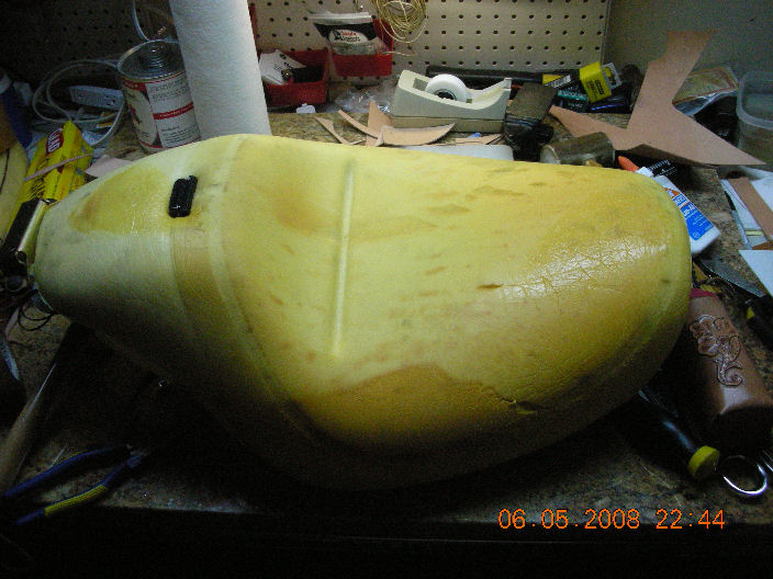

Ok, I know this is probably a stretch and asking allot, but I would like to see how you puffy seat guys (beeze) make your patterns for your seats. I have a seat that looks like this with the factory cover: And here is what it looks like uncovered: What my problem is, is the contours of the foam seat. I took the original vinyl cover, cut it up on the seams, and it is too stretched to give me a good pattern, and i have tried the covering it with plastic then covering it with duct tape to make a cover, draw out my seams and cut it up method.... it is too contoured to make a pattern from. I cant get my head around the contour part of it. This is pretty much what i need explained and shown to me. Thanks
