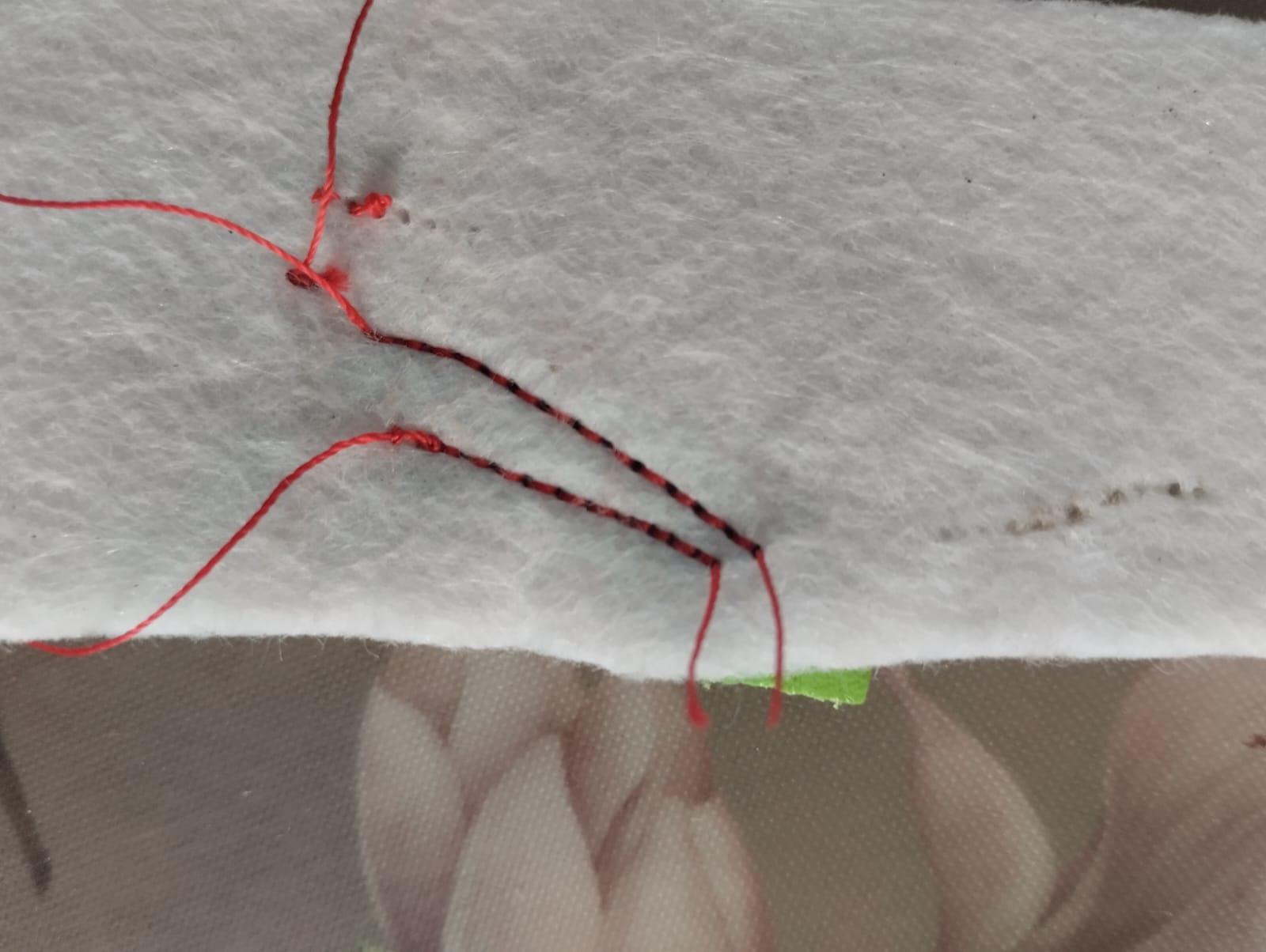

  2. Hi! I tried putting more pressure on the presser foot rotating the thumbscrew on the right edge of the back of the sewing machine and I tried sewing on a piece of felt plus the layers of leather and It sew like this Front Back Now I attached the belt but I have to regolate it a little bit as if I push the pedal with my foot the belt slips and the machine won't sew. Anyway do you suggest me to try to open the head of the machine anyway? I am going to replace the presser foot just in case the teeth are worn out
  3. The amount of top tension didn't make much difference turned all the way in vs all the way out. I had to loosen the bobbin tension a little bit so the top thread wouldn't show so much on the bottom side.

  19. @MelissaViarengo Looking at the pictures of your machine, it looks like the teeth have been filed almost entirely flat on the bottom of the foot. The entire feed is done by the teeth digging into the material. If those teeth are blunt, or missing, the foot cannot pull the material back to form stitch length. The teeth on the foot should be sharp to the touch. You can find replacement 29k presser feet on ebay in Italy. While you await your replacement presser foot, try adding some thin rubber or clear carburetor tubing to the feet. 1/8 inch inside diameter should fit on the legs. This may have enough grip to pull the work to form stitches. Add more spring pressure too.
