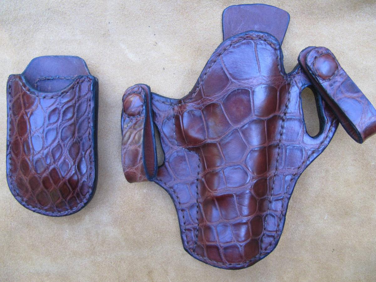

Glockinator here is a IWB pancake that I made so it could also be worn as an OWB. The principle for cross draw would be the same just adjusting the belt slots to get the apropriate angle for a cross draw. Your challenge is going to that it is a smaller holster and won't give you as much realestate to play with. -
