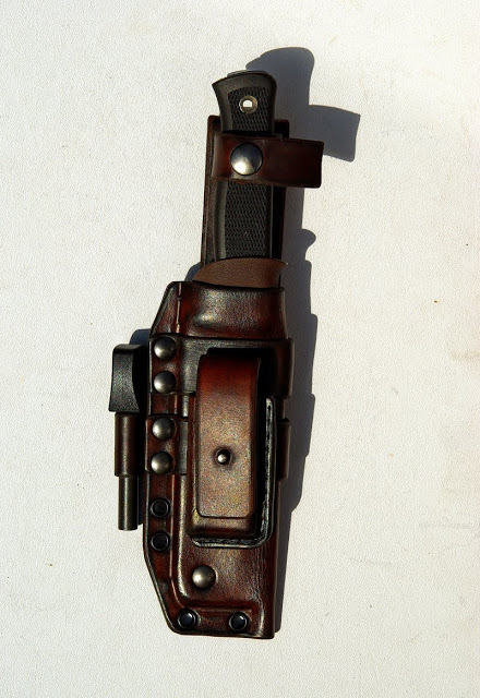

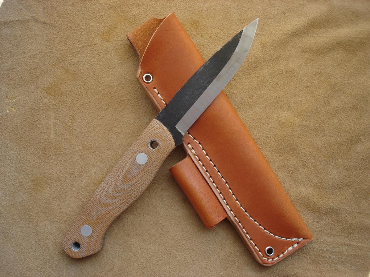

Acid Treated Knife
camano ridge replied to kiwican's topic in Gun Holsters, Rifle Slings and Knife Sheathes
Acid Treated Knife
I would go with a bush craft style sheath. Both knives look good. -
