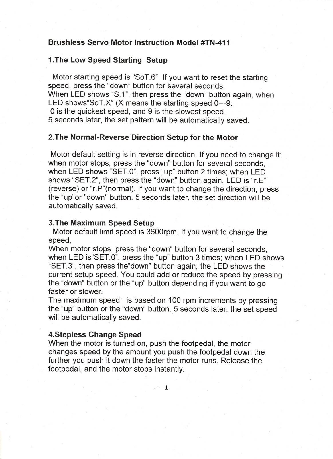

  17. Just got it & it's to slow??There is a knob on the front of the motor you can turn to speed it up. Please call anytime you have a question about your machine.
