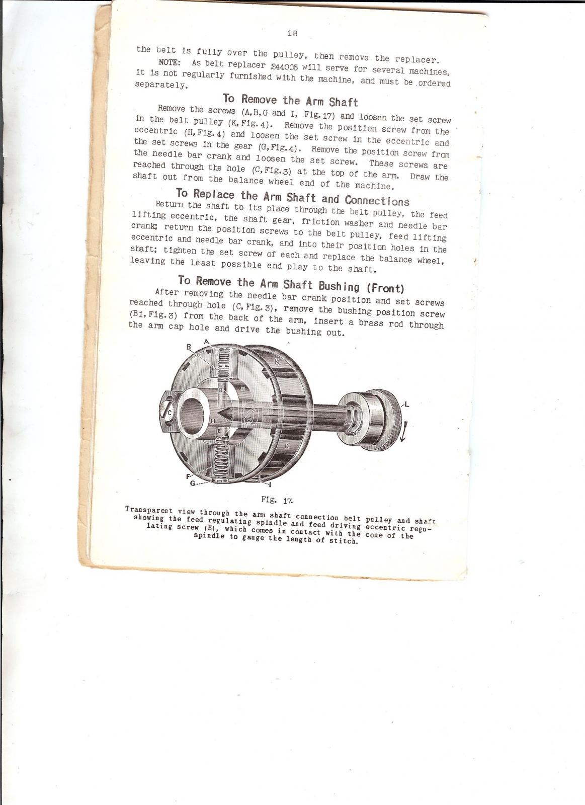

Here's a pic of a 211 clutch,the a & b lines need to be lined up on the inside hud & the outer pulley for the clutch to put the machine in time.You might need to tighten the 3-screws facing you when you look @ the cltch,these will make it kick out @ a higher torque then it might be set at(when you change the stitch your are knocking the clutch out of time like Constabulary says)
