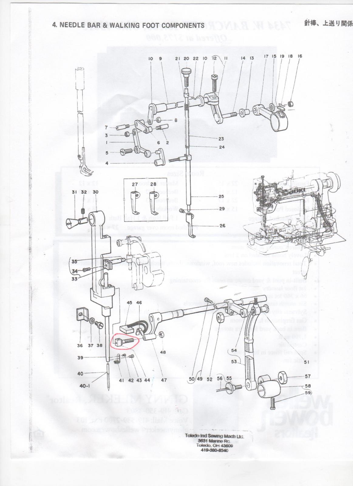

441 Clone Outside Presser Foot Screw
CowboyBob replied to TinkerTailor's topic in Leather Sewing Machines
That screw is a 9/64 40tpi. -
