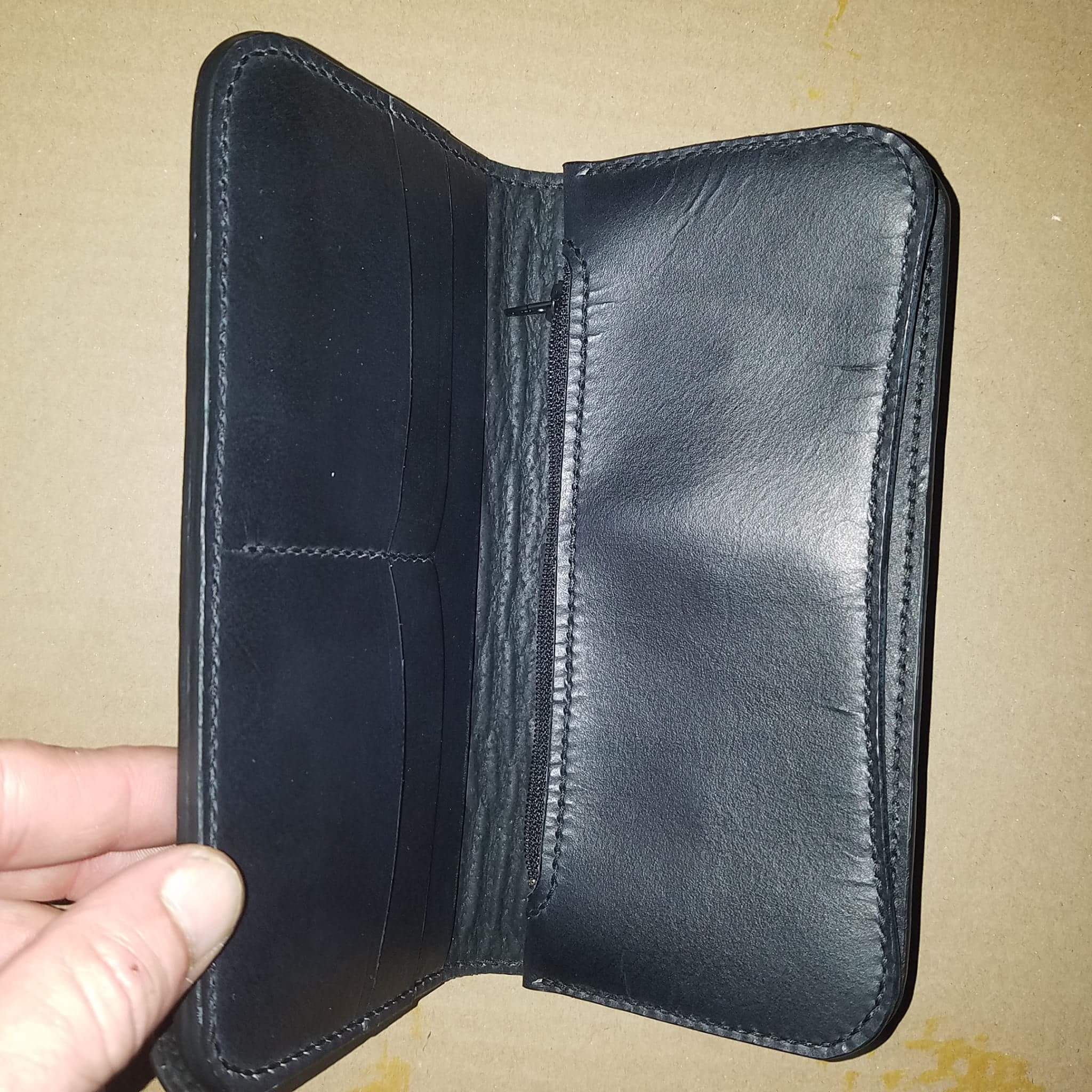

This is another style. Flat piece sew pocket in middle. Fold over and sew closed. It is either riveted or sewn to another flat panel then that is sew to the main body. These are called floating pockets I believe. Or Japanese style long wallets. There is a document pocket behind the zipper pocket also.this is 6 pieces of leather not counting the liner on this one.

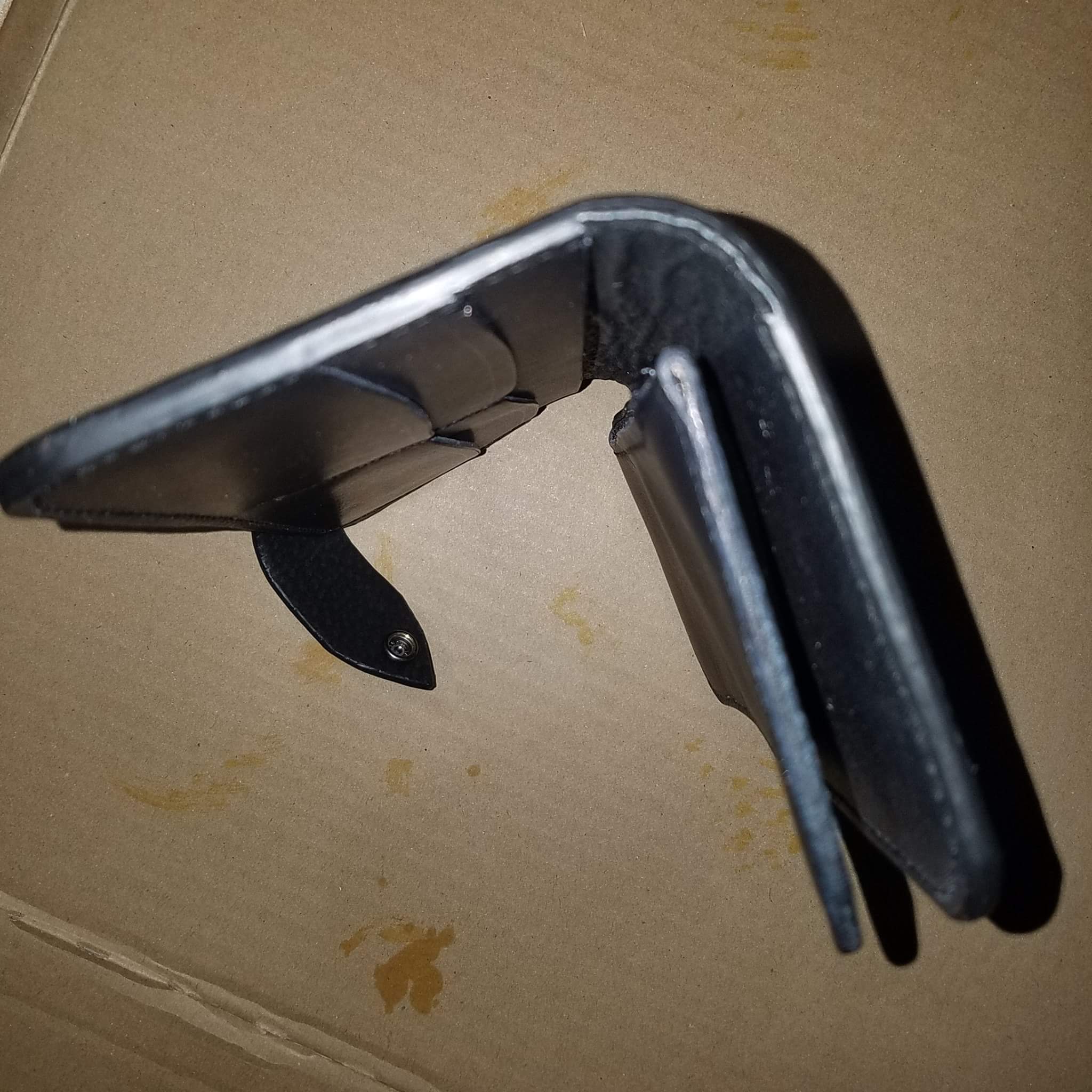

The base part of the snap. So there is a flat side where the leather folds instead of round.

This is the one from Makesupply. It comes with a zippered pocket too. Didn't have a zipper when I made it. I have made a couple with pockets now will send if can find pic of those. He has a YouTube video on how to make it too. I lined this one with pigskin. It's very stiff and needed the strap to keep it closed. It's edged with Tandy pro edge paint. I like it but overall I do like the unlined ones better. I have a more roper style pattern I got off etsy too. If look at my chain driven wallet post. Also the Makesupply one can be digital download or order a acrylic template. https://www.etsy.com/listing/458845044/leather-patterns-projects-vol-1-iss-4 This is the other pattern I used call a pocket secretary. -
