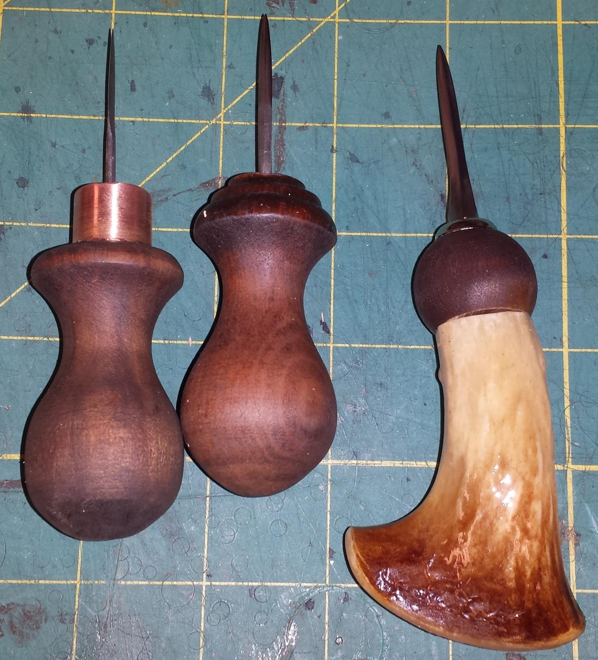

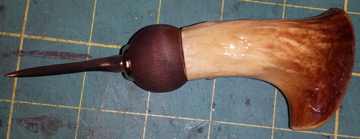

ok so I said I would post a pic of my latest awl it is HSS made out of a 6mm tap and an antler shed. It fits my hand perfectly the haft has a perfect curve to it as well as having a wide base to allow for a firm push. The awl blade has a width of 3.4mm and a thickness of 1.2mm-1.4mm as you can see in the photos the 1st two on the left are commercially purchased blades and the hafts were repurposed bed knobs from an antique bed. the one with a ferrule is 1/2'' copper tubing. I decided not to use the same on my antler haft in stead I used a wood bead to complete the haft along with a SS washer it works and looks ok to me. the 1st photo shows a comparative of the holes the 1st 2 are the commercially purchased blades the 3rd is my hand made one. comments are welcomed!
So far the awl blade is coming along nicely it's a little on the wide side at 3.4mm but thickness at the diamond is spot on at 1.3mm for the haft I am using an antler shed and a copper ferrule it should be done today! I will post pix in a new thread sorry for jacking this one.
