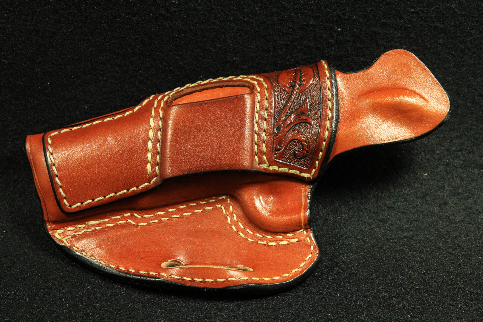

In case you're interested, I'm attaching some reference photos of holsters I've created from that pattern.
