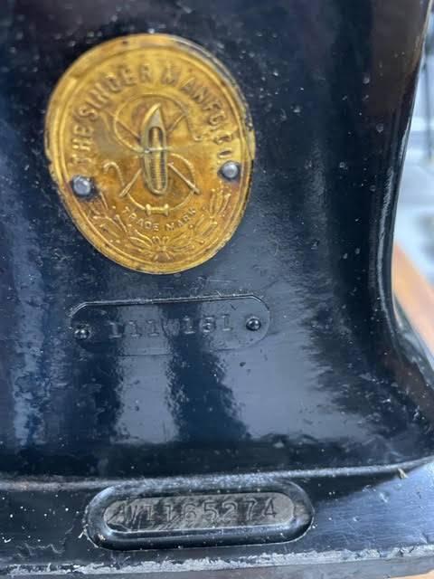

  25. Does anyone have the actual bobbin tension spec for the 111W series machines? In my case, 111W153 and 111W151. AndyTube cites a spec for domestics of around 25 grams and apparently got it from an adjusters manual or somewhere official. I've been setting all domestics I work on at just under an ounce. I like repeatability. I have a 151 that's way too tight. I'm going to set it around an ounce and start from there, unless someone has the actual number. I looked in all the pdf manuals I have and don't see an actual number. Thanks!
