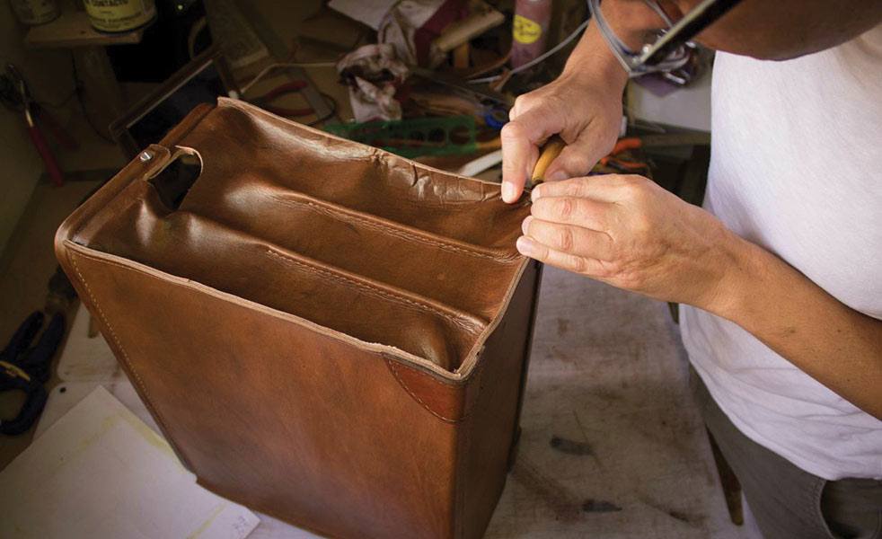

You have gotten some great advice, pretty much the ways I was going to describe. Try Springfield Leather for rivets, decorative and otherwise. They stock a large variety. They also are a great resource if you are into making jewelry. They will also provide a catalog if you like hard copies of stuff. Some of us still do! By doing turned-out bags and using fasteners such as rivets, you can accomplish a lot without showing stitches. Glues are also effective, depending upon what you are doing. Good luck!

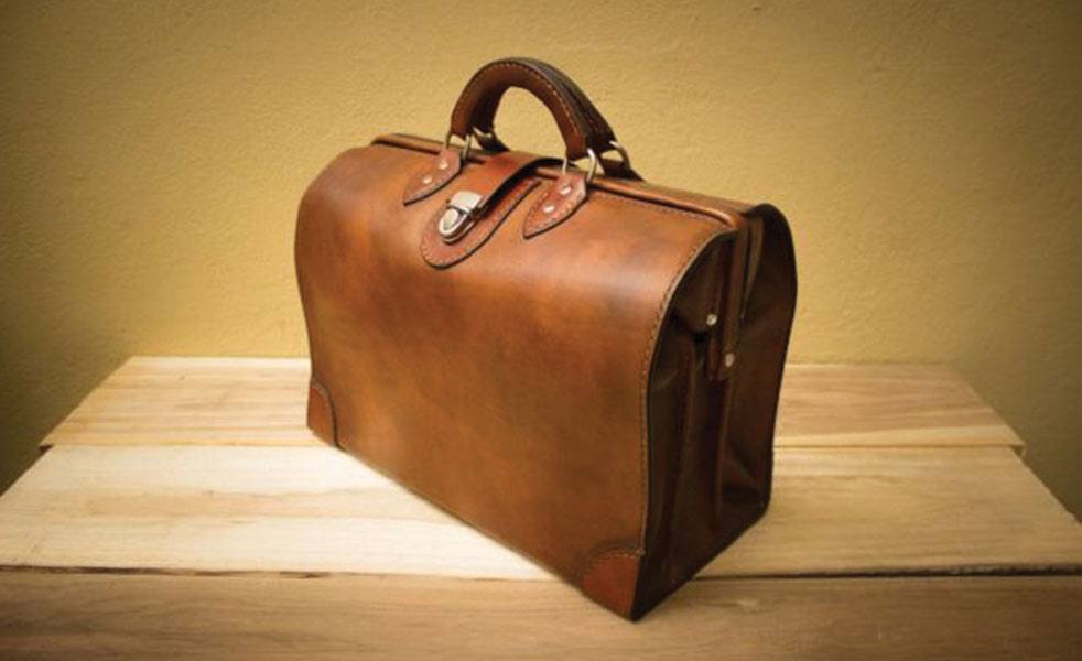

The overall design you are trying to achieve would be helpful. When I think of a traditional doctor bag, I picture this.Not much round here. I doubt the "darts" are necessary but skiving is helpful when doing any sort of radius. I have made several turned out leather mail bag briefcases and never cut any "darts" nor did I need to skive. I used 4/5 oz. on the majority of them. This style bag only curves when closed. -
