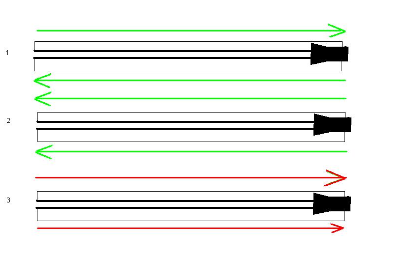

You didn't say how long the sides of these were, . . . I'd opt for some clear plastic French Curves, . . . lay the groover next to it, . . . do one side, . . . flip it over, . . . do the other side. May God bless, Dwight
