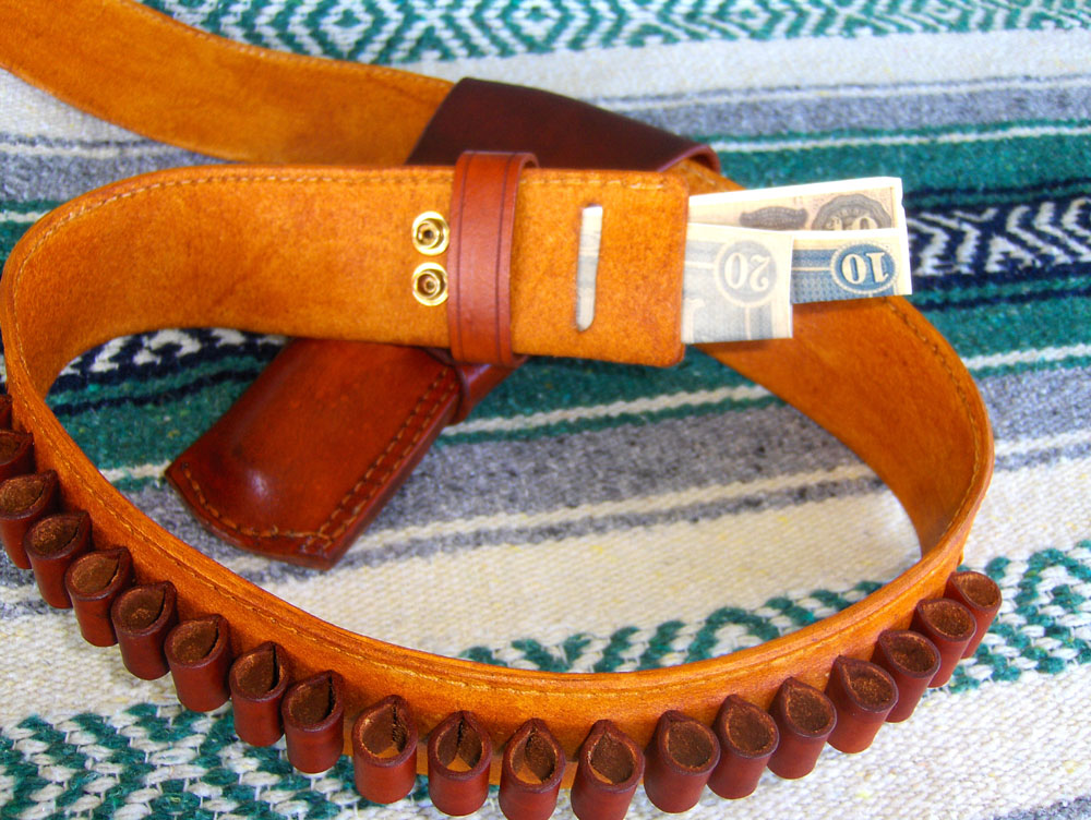

  12. If I felt confident enough to use a SAA for my CCW, . . . I'd borrow the design and all, . . . and do one for me. The only thing I would change, . . . is I would make my belt tunnel between the two sets of Tee nuts, . . . As it is, . . . I barely feel confident with my 1911, . . . so I don't think I'll rock this boat for now, . . . But I am gonna think on it. I'm thinking shades of McCloud's, . . . cloud, . . . are wisping over me right about now May God bless, Dwight
