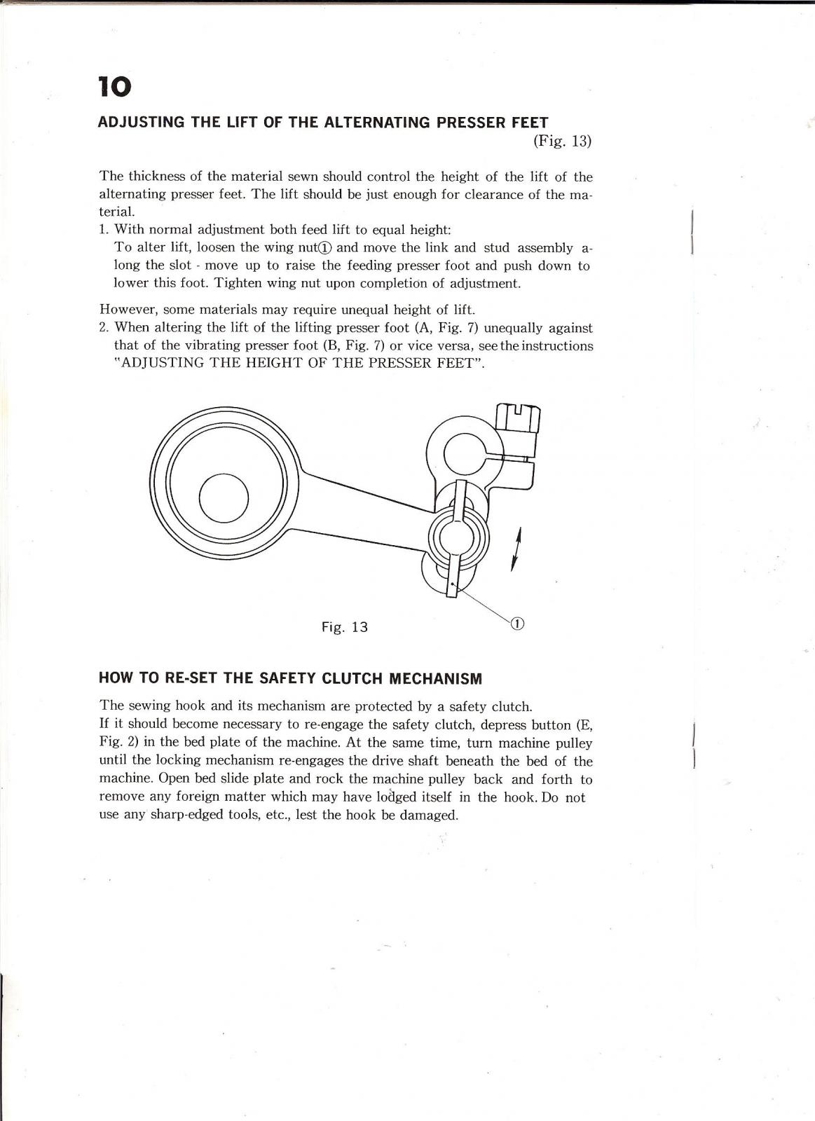

You might check to see that this adjustment on the wingnut on the backside so the line is pointing to the m or h see fig#31
