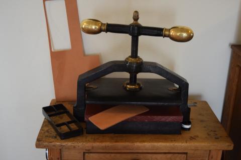

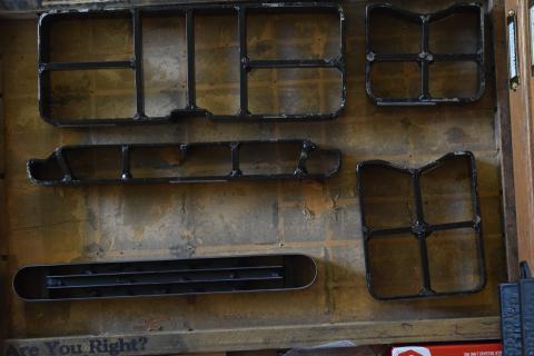

	This is what I click with my bookpress: Wallets, business cards, lifts for shoes, coasters, and Mystery Braid Bracelets along with various circles from 1-1/2" to 4". Just to test, I located the thickest, toughest leather in the shop (10 oz. dry old pig skin) and used the bookpress to click a wallet back. It was not clicked in one step. I first put the wallet back side in the press and pressed, then the center of the wallet back, then the side, and finally the center again and heard the "click". It clicks up to 6/7 oz. in one press. The press plate is 10" x 15". As with any press, the more intricate and larger the clicker die the more pressure is needed. I used some physics math and calculated (based on screw thread and radius if the handles) the pressure exerted to be approximately 5-7 tonnes based and my strength. I confirmed it the last time I was at the Sheridan Leather Show, when I took a sample and used the smallest Weaver manual clicker (5 ton) at the Weaver booth, and it performed just like my bookpress. Most of the time I use the press to emboss (imprint) leather with old letterpress lead type to place text on leather. You can see a business card in the back ground for an example. Hope this helps. Oh, by the way, I have been using that particular bookpress for 14 years... Bob Stelmack
	I use a bookpress. Over the years I've acquired three of them. Paid around $100-$230 for them. Use for both clicking and impressing (embossing) patterns in leather with letterpress lead type. Bob Stelmack
