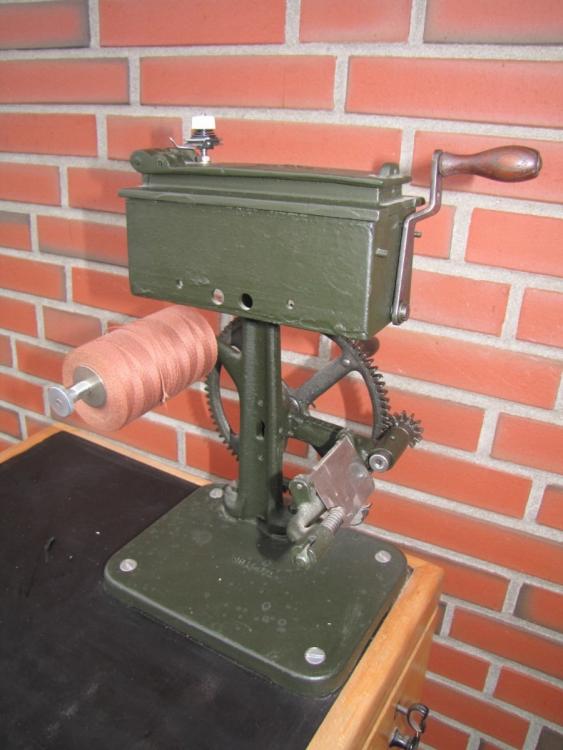

Bargain Sewing Machines in the UK once sold table mount bobbin winder for the barrel type bobbins on Ebay and Amazon. https://www.amazon.de/Bobbin-Winder-Bullet-205-Industrie-N%C3%A4hmaschinen/dp/B077638XPY https://picclick.co.uk/BOBBIN-WINDER-FOR-BULLET-BOBBINS-ADLER-Industrial-Sewing-272977530963.html Their website is gone but maybe you can contact them through Ebay. Singer and Adler produced feet for these jump foot machines. They are very hard to find. Unfortunately there are no after market feet for this machine.

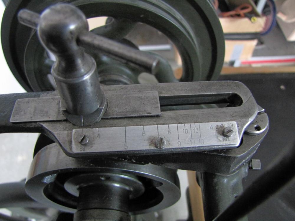

I also added a thread holder I found on Ebay a while back. I also figured when you remove the silver limiter which is mounted to the stitch length lever and grind down the feed dog a bit on the backside you can achieve almost 5mm / 5SPI stitch length - original stitch length was approx 3.2mm The paint once again is VHT crackle / wrinkle paint -

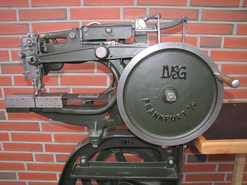

I picked up this machine ~10 ago in Munich. No idea what this machine could do or not or if it will suit my need at all. You barely find information on the 51W machines and especially not on 51WSV2 (Special Variant) - I mean stitch length and so forth... However, I did a lot of research and figured there are 2 different 51W post bed models. Mine is the earlier one based on a Wheeler & Wilson N12 (as it seems). I found a picture on Alex Askaroff´s website (scroll down). The later models (made after 1938 as it seems ) are more Singerish than the W&W based 51W model and have a different tension unit, stitch length adjuster, thread lever moved to the front... and so forth. Lots of features you also find on other Singer models like 108W, 107W and so forth. So what I have is the earlier model. On the back side you still can see the cam for the trimming device which was mounted on the top of the machine head. https://sewalot.com/wheeler%20&%20wilson%20sewing%20machines.htm Singer took over W&W in 1905 and even produced some W&W machines 1:1 but with Singer label. That probably explains the short serial number w/o prefix - I guess Singer produced some SV machines with from existing (already cast?) W&W parts - this is a wild guess, I know. Anyway - machine was badly gummed and VERY dirty inside - sorry I did not take pictures. I figured it uses an odd needle system 128x2 / 128x3 (short needle with thin shaft) so thats nothing I could use. The NB also has an odd cut out and seems someone already "bubbaed around" on it's not functional att all So I robbed a needle bar from my old Singer 111D which rests on a shelf for some years already and - surprise surprise - the needle bar is pretty much the same so I now can use 135x17 needles - downside is the 111D needle bar is shorter. It works but I have to install a extra guide (have to figure how to do this - already have an idea). Next think is the presser foot bar - looks like it can accommodate 111 type needle feed presser feet or 107w presser feet - but thats a bummer too cause the 51W presser foot bar and feet are slightly different... Next idea - I take the PF bar from the 111D and - surprise surprise #2 - it perfectly works and fits and now I can use wide spread 111 needle feed feet and similar. But I decided to try a PF bar with fixed roller foot I once bought "in wise foresight" cheap on ebay a while ago and it also works perfect. Next thing was the badly worn hook and bobbin case (0.5mm horizontal and vertical play ) The machine already has a rotary hook but without bobbin case opener (later 51W models have a bobbin case opener). So I removed the hook from the machine and figured it has the exact same mounting as the Singer 136w / 153w hooks which are the same as some of the Durkopp hooks I have in my parts box - so I installed one and - holly crap - it works perfect even though the Durkopp hooks where meant for using with a bobbin case opener but seems it does not matter in this case . But -belive it or not I found a source for an original new hook but they ask $80 + shipping (+ EU VAT and import tax) to I will keep the Durkopp hook - good think is I now can use the bobbins of my 111 and 212 in this machine and don´t have to stock different bobbin types. So - lot of words... here are some pictures. I know most would have kept the original decals but they aren ot as nice as they seem and I personally do not like the Singer floral design very much... This is what I have found:
